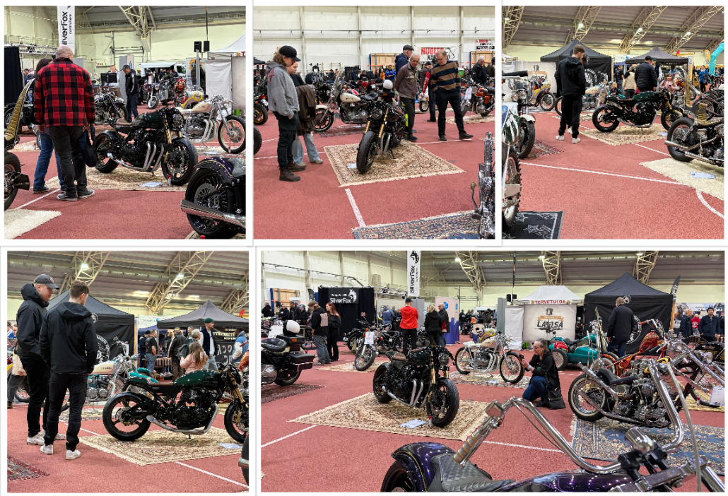

Who the hell came up with idea to have those carpets under the bikes, was the King Solomon himself sponsor of the event!?:laugh2::laugh2::laugh2:
Very good question. Persian flying carpets. :D
Apparently this has been around for a long time, but solid colors would make the bikes stand out better.
It appears from the striping on the floor that the venue is a gym or some other type of sports venue. Probably trying to protect their floor from all those Harleys marking their spots. :D

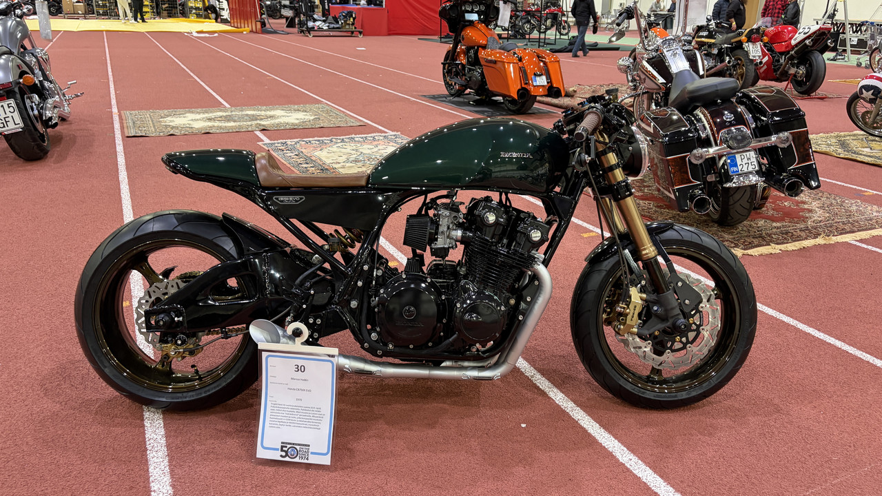

47th American Car Show 2026​
Another long exhibition weekend behind us.
This time the destination was the Helsinki Expo and Convention Centre for ACS 2026.
Prep & Arrival​
Final polishing and “packaging” of the bike in Tampere — then loaded into the vehicle and off we go.
Found the display spot, positioned the bike, and switched to "free weekend mode".
At the Show​
There was a lot to see throughout the weekend, and a total of 60,000 visitors came to admire the vehicles on display.
My bike also attracted a steady flow of interest at times, and I had several great conversations with visitors and fellow builders.

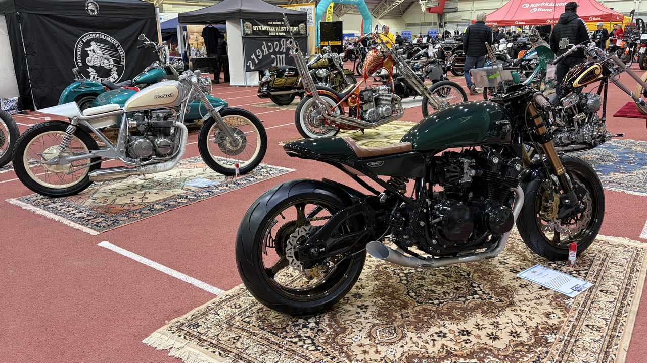

45th International Hot Rod & Rock Show ’26​
Last weekend, a show was held here in Tampere — practically on home ground — where the Honda was once again on display.
The weekend felt noticeably lighter this time, as the event was basically right next door.
At the Show​
The bike also got to enjoy its first proper sunlight in its current form.
The Honda attracted interest at the show, and once again there were great conversations with several other builders who had brought their bikes to the event.
This time my bike didn't win any awards — most of them went to Harley-Davidson builds.

The final show also took place before the bike was taken to the workshop.
Custom 2Wheels was held in Hämeenlinna, marking the end of the 2026 show season.
There were a lot of really nice bikes on display, but the show was heavily focused on the Custom / HD scene, and that's where the awards went this year as well.
Both builders below (father & son).
The show season is now officially over, and I don't think I'll be entering any more shows next summer.
It's been fairly exhausting and expensive.
However, I'm extremely happy with how the whole show season turned out, and the final tally was:
SEVEN SHOWS, SIX AWARDS 🤩
