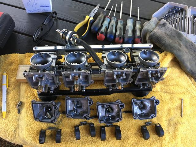

Finally, I got the package and these beauties were inside:
From 1985 Suzuki GSX-R Mikuni VM29SS Flatslide carbs
The package included 6 sets of different size jets.

While they made this fitment, they checked the condition of the carbs. Everything was good. The only thing they fixed was twisted choke rod.
Still, have to clean outer shell of the carbs.

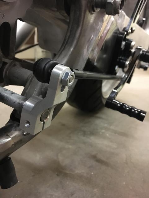

Three most crucial jobs are to get chainline corrected, make a new bracket for rear shock(s) and to fabricate rear cowl.

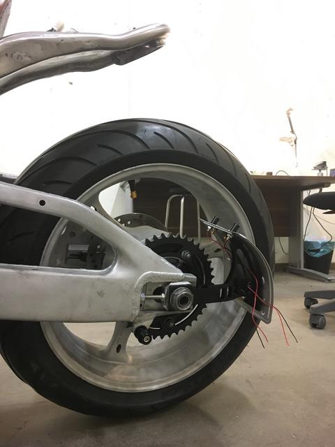

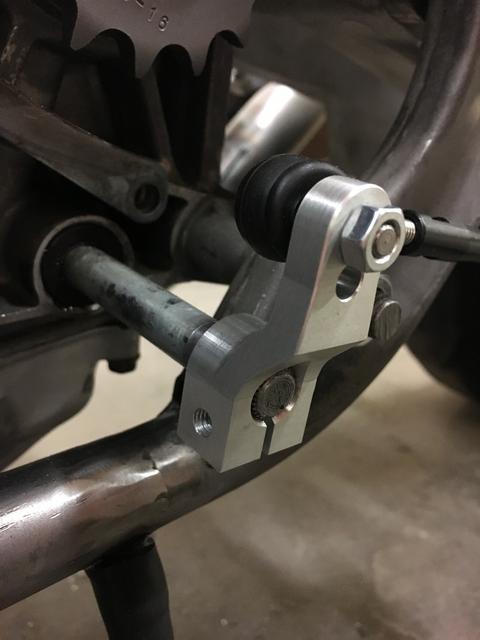

Bought new rear sprocket and chain. The chain is 530 X-ring and rear sprocket is Snell's 40 tooth.
We've been fighting with the chainline to long. Finally I can say it is straight! Problem was solved with that offset front sprocket.
It helped a lot when I bought chainlining tool. It doesn't looks bullet straight in this pic, but should be
We replaced rear chain tension bolt, because old ones were damaged and they had very small head

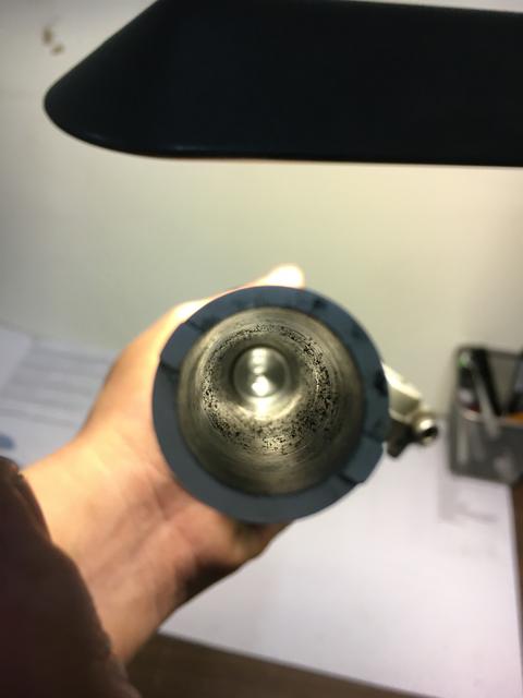

Rear shock.
Original GSXR1000 rear shock had a gaschamber and it was way too close to the carb, so I couldn't fit the pods.
Finally solution was to buy a new rear shock
YSS MZ456-305TR-28X. Model is made to fit in Honda CB600 and length of it is 305mm.
Only problem was that this shock had loop-style lower end and I needed fork-style lower end. Also this shock doesn't have interchangeable lower end.
Original fork-style lower end
New shock with loop-style lower end
After some googleing I contacted YSS seller in Finland and they said straight away: "Sure we can change it" :thumbsup:
Sended shock to them and after couple days they had switch the whole lower body and center arm. Lenght extended from 305mm to 320mm, which was better than great to me!
Ready to rock!
Now rear shock is attachted. Shock is just right length and has great stiffness, so when you sit down, the rear end doesn't get much lower than in the pics.

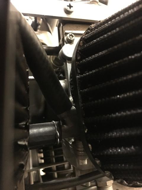

4into1 send me a package. It contains new pods, sidestand spring and exhaust gaskets.
Pods look and feels good and finally they have enough room to fit in. :thumbsup:

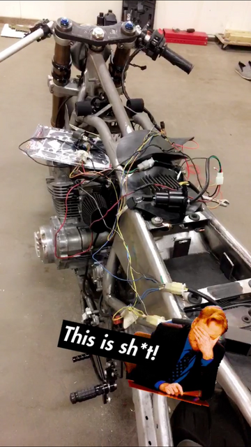

Next huge thing is to settle wires and start this beauty for the first time in 18 years. Fingers crossed!!
First step for the wiring is done, but lets get back to that later
Original wirings

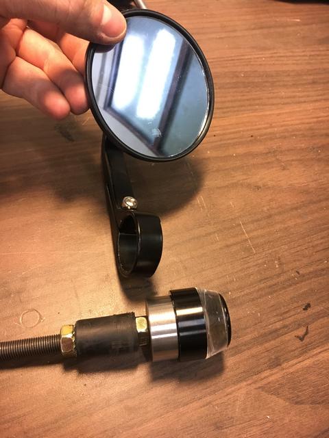

Months ago I bought bar end mirrors and turn signals.
Just like I thought, I can't install them at the same time because they both use same kind of fastening.
I really want mirrors and turn signals to my bike, although legally you could leave turn signals and one of the mirrors to the garage.
So we came up with this plan:
From the factory this is the set-up. Lens -> threaded rod -> rubber -> washer -> nut.
By tightenin the nut rubber will expand and when you push whole thing inside of your bar, it should stay there.
(same set-up with the mirrors)
This is what we did.
I bought same size threaded rod but longer piece. Drill it through, so it became threaded tube and pull the wires through.
Rod to the lens -> fabricated metal sleeves(?) for the mirror -> mirror in -> nut to tighten mirror to the lens -> Rubber piece (will buy longer one) -> washer -> nut.
Pics:
Exploided set-up
Finished set-up
This way I got what I wanted.

All the parts for the first startup is now ordered and should arrive in next week.

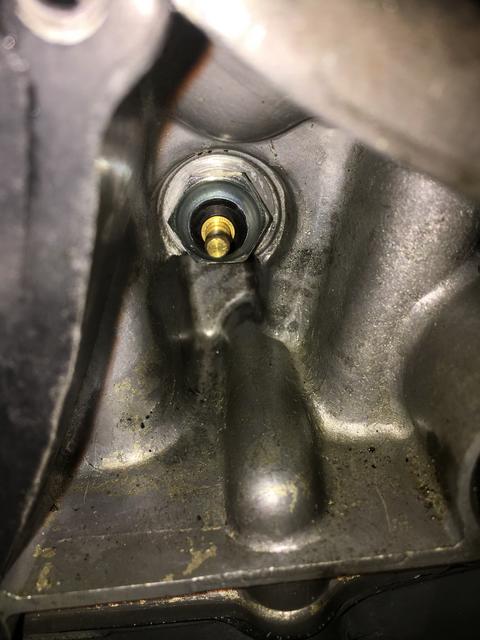

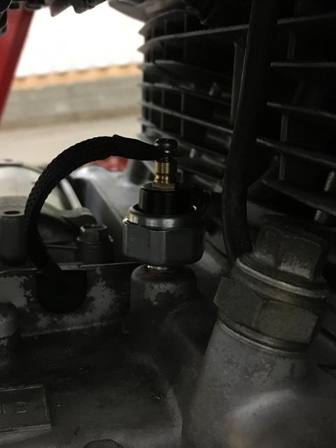

I ordered a new neutral switch, an oil pressure switch and a small diode for the main wiring.
All the hoses, filters and wires has already arrived.

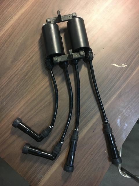

New coils, sparkplug wires and -caps
All main wires are connected. (battery->ground / battery->starter relay / starter relay->startermotor)

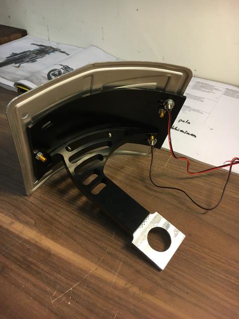

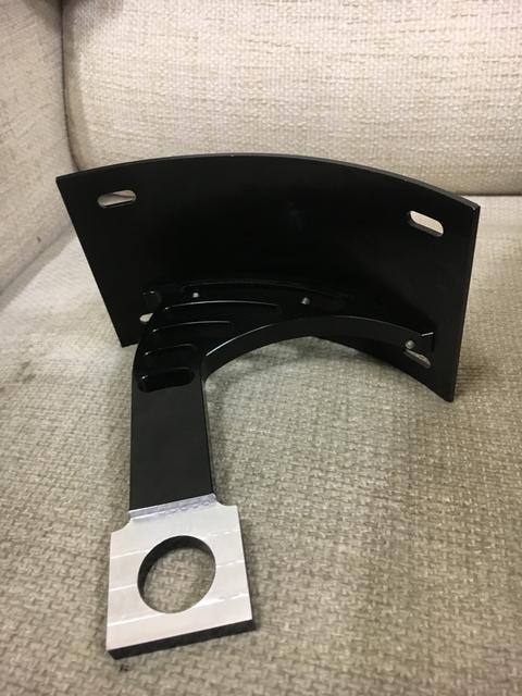

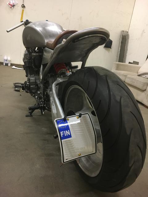

Location of the licenceplate... Well had to make decicion and the plate found place side of the bike.
Workshop machined 1/3 off from the bracket so it have a step in the bracket and can be locked to end of the rear swing.
Licenceplate lights

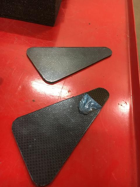

I was bored so I made these carbonfibre plates to cover front fender fastening points.

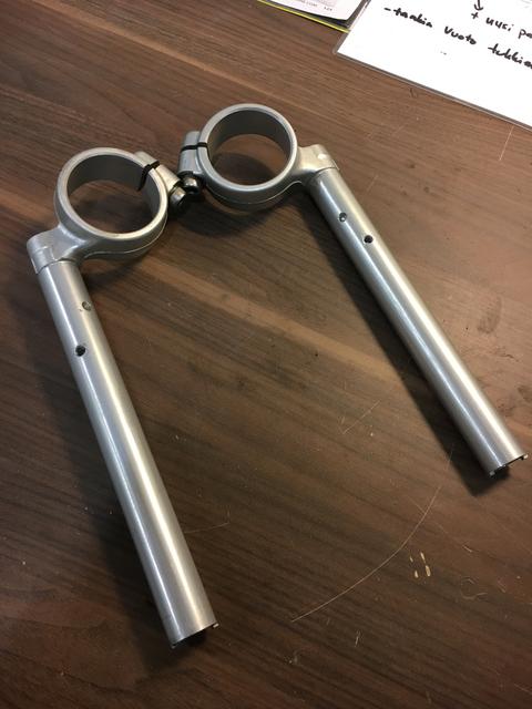

I picked up my clip ons from the workshop.
They drilled inner hole longer and made hole to the side so I can get front turn signal wires out.
This is the final setup
For the final setup we changed few things:
I made new metal sleeve that goes straight through to mirror. To this sleeve we made threads so it can not rotate.
Also we drilled the locking pin through mirror and that sleeve, so the mirror can not rotate on the sleeve.
At this point it might work :thumbsup:

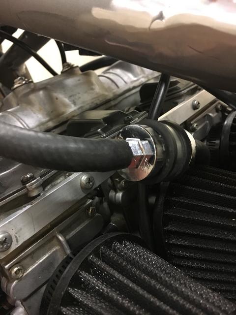

Fuel lines done
Fuel line from the tank -> fuel filter -> carbs.
It was little tricky to figure out where and how to put fuel filter without too much "uphills" and turns to the hose.
I used pipeclamp with rubber insulation to hold fuel filter in its place

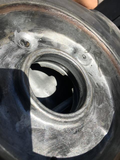

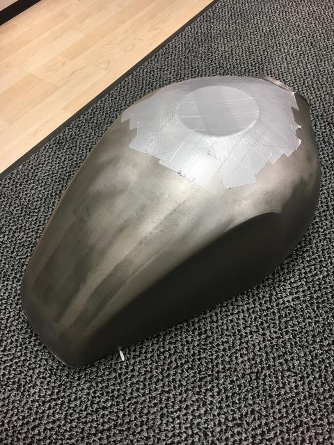

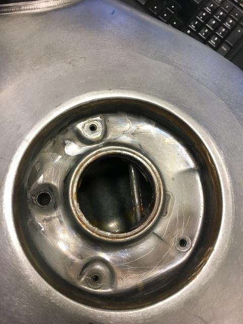

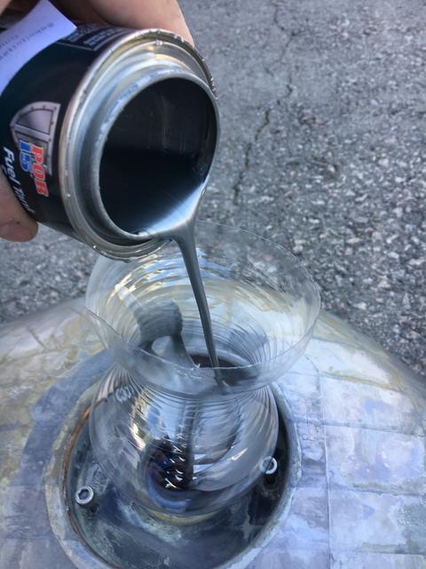

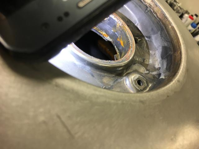

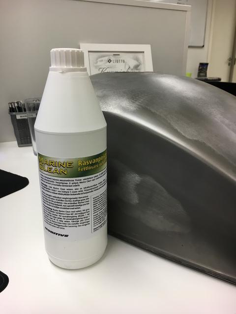

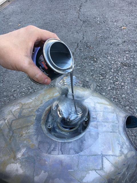

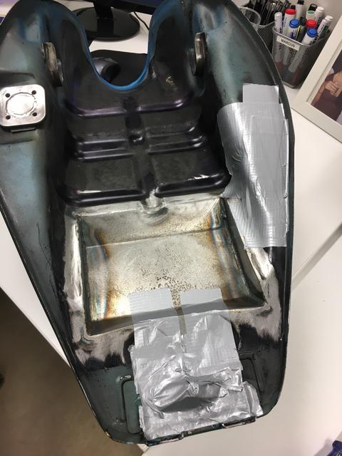

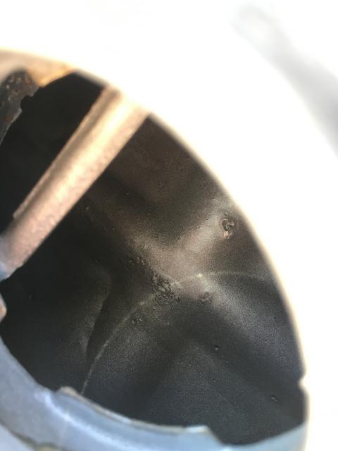

Coating the tank
The fuel tank is old and has little rust inside. When I filled it with water, it was all over rust-colored when I poured it out.
Also you could hear little crumbles rolling around at bottom of the tank.
I bought Por15-kit.
First I have to say you all who are planning to do this: the process is from hell and takes huge amount of your time :thumbsup:
First instructions advice you to flush the tank with fresh water to get bigger particles out straight away.
Remove every removable part (petcock, fuelcap etc.)
After that you have to clog all holes excluding filling hole.
First issue comes at this point. As you may know or guessed, these duct tapes doens't hold when you are going to use hot water...
My advice to you is to fabricate pieces from a sheet metal or something that you could bolt tightly to cover holes.
1. step in the real process is to put Marine Clean in. Add same amount hot water.
This will remove grease and other not-wanted-stuff.
After that seal filling hole and pray it will hold :D
I shaked the tank about 15 to 20 minutes and after that I let it stand 10 minutes on its each side.
Finally flush it with fresh water to get all cleaner out
2. step is to put Metal Prep in. It will prepare metal to receive coatingliquid.
Same process again. Clog holes, metal prep in, seal the filling hole.
I shaked the tank approx. 20 minutes and after that let it stand 20 minutes on each side of it.
Finally flush it good with fresh water. Even the last drop of metal prep has to get out.
After this you should get the tank 100% dry and fast as possible.
I took the tank outside to the sunlight... (its been crazy May in Finland. Temperature between 24 to 28 celsius. Normally we would talk about 15 celcius)
I shaked most of the water out and finally put hot air blower to heat up. (you are not allowed to use compressed air)
Last phase its coating
Before you clog holes one last time, you should put bolts in, because coatingliquid will coat up threads also.
You should not shake the canister, because it would produce some air bubbles and you don't want them. Although you have to stir it well before using.
Liquid in, seal holes and gently rotate tank all around.
Many times I thought will this work and will it cover all edges and sides of the tank.
Apparently liquid is pretty "smart" and will expand all over the tank.
After rotating 15 minutes I poured excess liquid out and cleaned outside spills asap.
You should use gloves because this stuff will be in our hands atleast two weeks :doh:
It will dry 96 hours and after 7 days you can put gasoline in.
These pics are after two days of drying and as you can see, some air bubbles formed during the last phase.
Surface looks good
I'm not sure did I post picture of this already, but my friend from the states dropped me cognitomotos gearlever adapter.
In these pics adapter is in wrong way because gear selection order is upsidedown.
What comes to wiring this beauty, new diode arrived...
...new neutral switch...
...and new oil pressure switch.
We are now going through wiring and this picture shows my mood atm
This wiring sh*t is not my cup of tea.
But will see...

Wiring this bike was pretty difficult for me and finally I made a decision to buy a m-unit with goodies
Set included m-unit V.2, m-switches and m-button
With these great items I figured out wiring and also made it very easy.
Finally bike was ready for her first start up

Also two carbs was overleaking and we found out that needlevalves were faulty. Ordered new ones and changed them. Doesn't leak anymore.
My to do -list is simply and ready so I know exactly what to do and everything is already planned.
