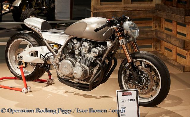

Update - Deadline 1.
End of the last year, I decided that deadline for my bike is 31th of January, so it should be in Finlands biggest motorcycleshow in early february.
As you can see, I didn't make it, BUT I got a call from event organisator. They would still be happy if my bike can make it, even it is not ready...
So 2.-4. of february my bike is in the show.
It is not painted nor 100% finished, but still.

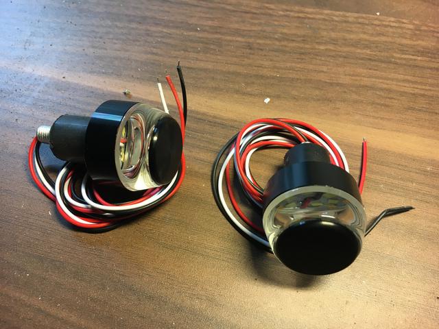

Start-button
As I wrote, I got start-button from a friend.
We scan it to 3D-model and after that printed it.
It came pretty good. Few minor grinding to do, but it works!
Original button
First version
Final version
Need to polish it and its good to go :thumbsup:

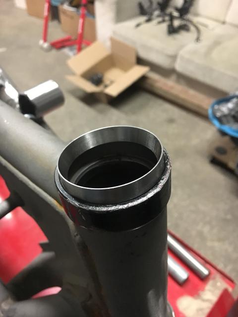

Steeringstem
Way back I ordered steeringstem adapter to fit GSXR front end to CB750 frame from Cognitomoto. Like they said, it is almost bolt-on.
Original GSXR stem in triple tree, next to new stem.
Just press the old one out and new one in
Here you go.

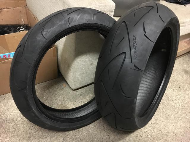

Just arrived. New tires, blinkers, bolts and nuts...

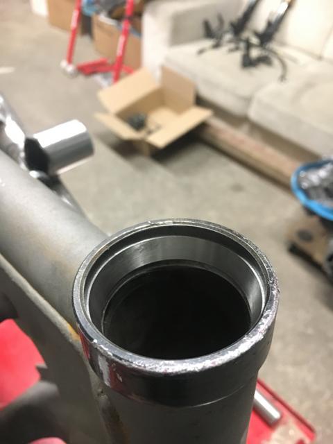

We are now swapping front end with correct parts.
As you saw in my last post, stem is already in its place.
Yesterday we push bearing housing to the frame.

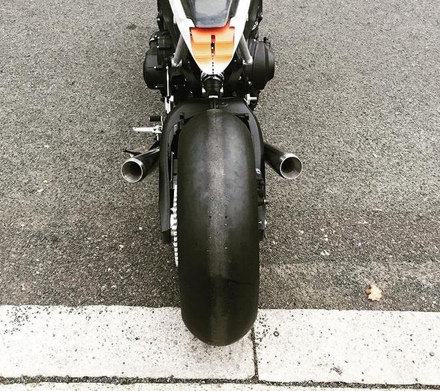

I ordered two silencers and they look like this:
Exhaust tips will come like this, but not that far:

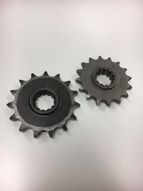

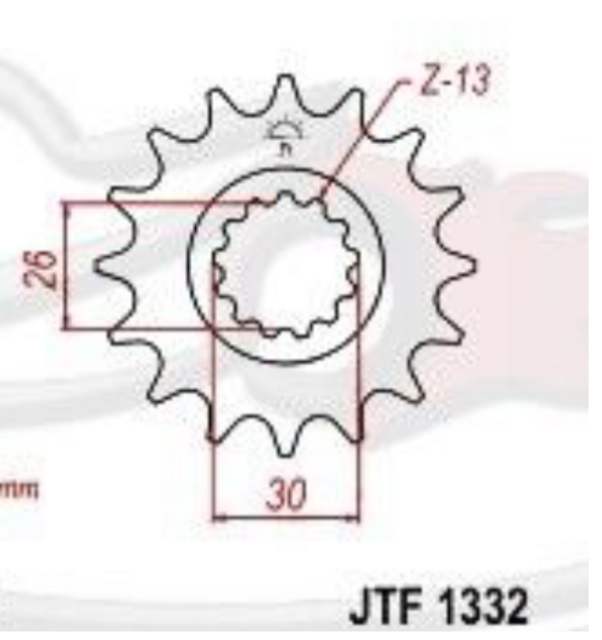

3) Front sprocket is on my searchlist. Below you can see original splined one. I would like to buy 15- or 16-spikes on 530-chain.
What bikes share the same splines? (VFR?).
4) Is the original front sprocket to chain 530 or to something else?
Has someone welded two sprockets together, to get some off-set?

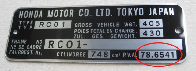

6) Where can I order new VIN-plate for my bike?
Picture below.

Similar with the VIN plate, not supposed to be easy to get those, what every bike stealer in the world asked for at Christmas.

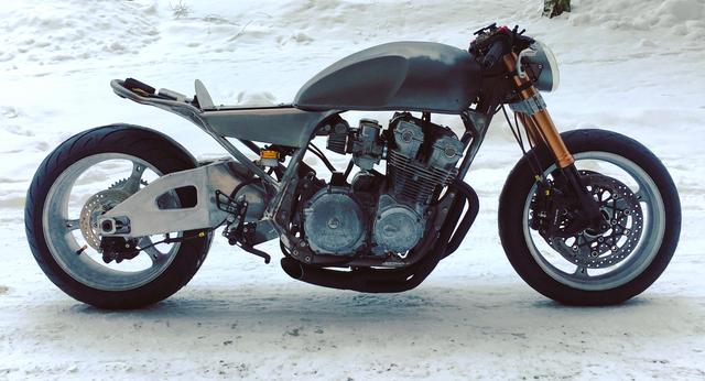

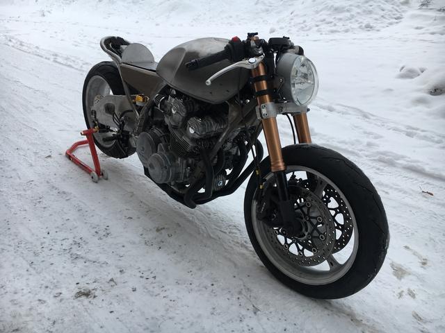

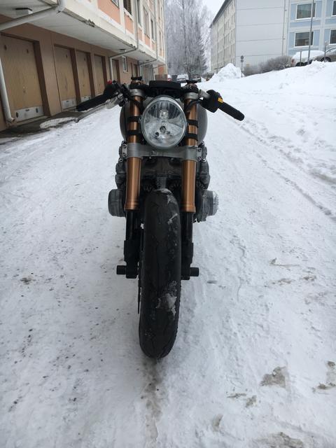

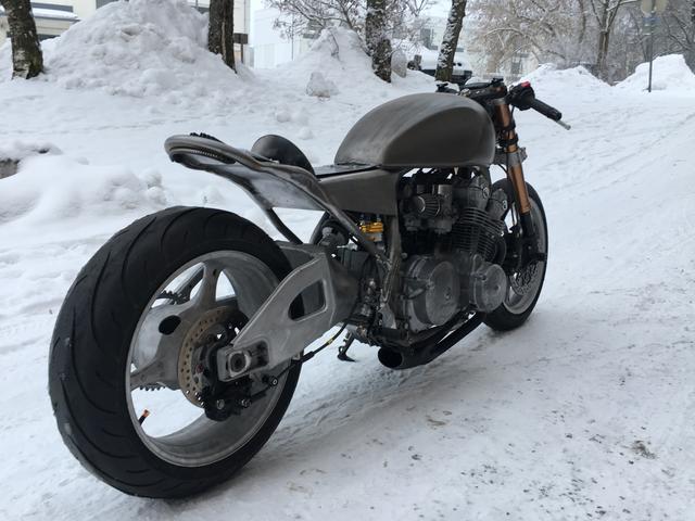

Today we put bike "together". Only 1,5 weeks to go before Finlands biggest motorcycle exhibition.
Lots of parts are now in place but fitment is something like "almost alright", if you now what I mean.
Front end not in its place, upper tripletree and speedometer is too high. Carbs are just hanging there and there is not enough room for middle airfilters.
Exhaust is not the one, which will finally be there. Shiftingrod is attached with zipties. Etc.
So we have less than two weeks to finalize as much of the parts as we can.
Main thing is to work on rear cowl to make bike look more ready and few carbonfibre parts has to fabricate.
Still here is few pics. Feeling much more satisfied when I look my project right now. Looking good for my eye :thumbsup:
If you are in Finland between 2nd to 4th of February, visit Exhibition Center in Helsinki :wink2:

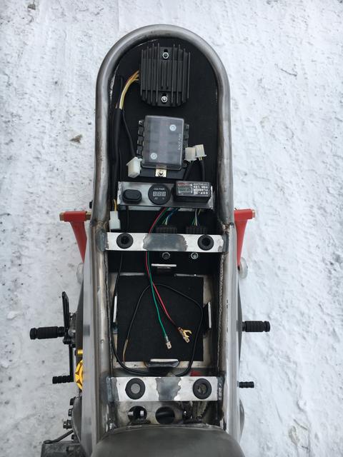

Out of curiosity, how did you extend your wiring harness to reach to the end of the bike frame? My wiring harness is limited by the length of the wires primarily the fuse box mounting location and the wires coming from it.
We are going to do all wiring from point 0 to 100.
So I mean we are ripping every single wire out and put all new wires in.
We are also going to make much more simple wirings and get rid of few unneccesary wires.

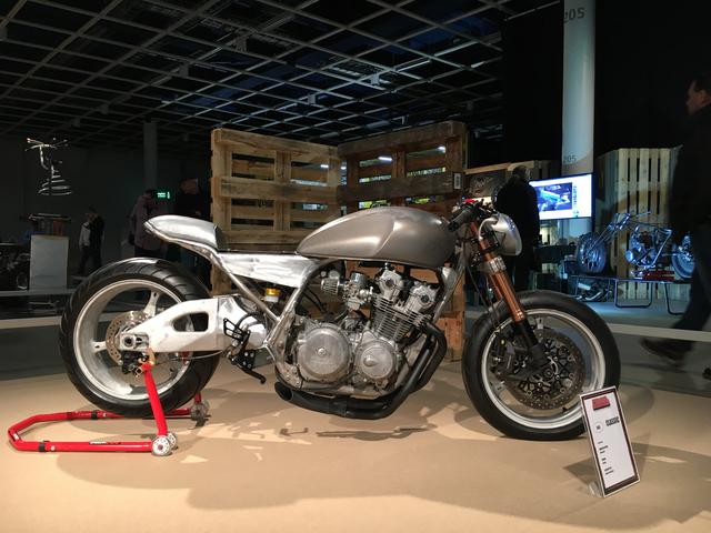

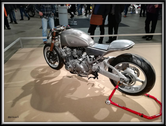

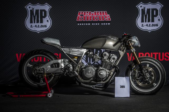

Exhibition weekend was last week and it went great!
We had a blast!
Here are few pics from the event
Nice to see lots of people looking and talking about my own project...
As you may have already guessed, I didn't won in any class :D
Bike is way too unfinished, so we will have to wait until next year...

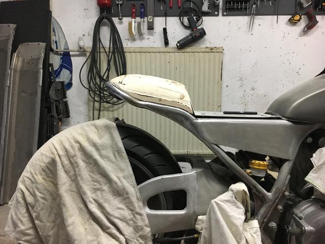

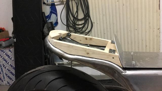

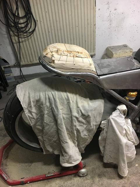

You also might note that rear cowl is looking like s**t.
I made it in one day from woodboards :laugh: I thought that it will look pathetic if I don't make some kind of rear cowl.
Base is almost finished
Lots of grinding and some more grinding
This is the final shape and after that, I used filler, then some more grinding and finally put paint on it.
This will not be even close to what I'm looking for to do.

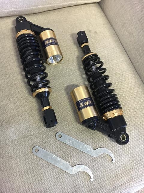

I don't have enough room for two middle pods, because rear shock has its capsule/container in the way...
Well I just bought new shock(s) and thinking of doing something uncommon... Stay tuned...

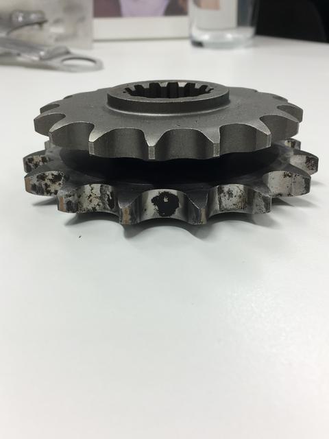

Today my friend is welding my sidestand shorter, because bike is way more lower than original, sidestand cannot be used right now.
He will also weld offset front sprocket.
Chain will be 530.
Old sprocket will go to turning machine (lathe) and it will remove all teeths from the sprocket. Also centerledges on both side will be shaved off.
New sprocket will have its one side centerledge to go.
After previous step, they will be joined together.

Friend of mine finished welding the offset front sprocket.
Looks amazing and works perfectly
Have to do minor work for the chainline. It is almost straight, but not enough yet
